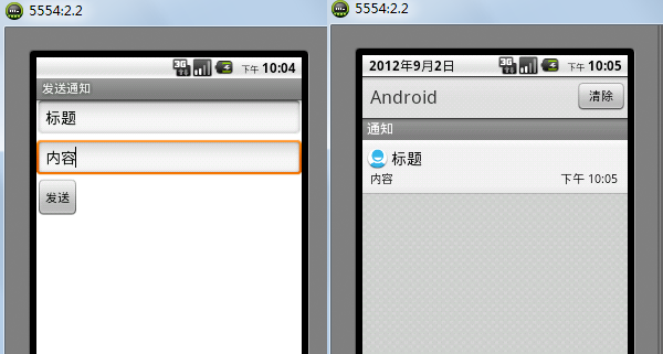

实现代码如下,代码中有详细注释:
[java]
  1. public class MainActivity extends Activity {
  2.     private TextView tvTitle;
  3.     private TextView tvContent;
  4.     private Button btnSend;
  5.     private String title;
  6.     private String content;
  7.
  8.     public void onCreate(Bundle savedInstanceState) {
  9.         super.onCreate(savedInstanceState);
  10.         setContentView(R.layout.activity_main);
  11.
  12.         tvTitle=(TextView) findViewById(R.id.etTitle);
  13.         tvContent=(TextView) findViewById(R.id.etContent);
  14.         btnSend=(Button) findViewById(R.id.btnSend);
  15.
  16.         btnSend.setOnClickListener(new OnClickListener(){
  17.             public void onClick(View v) {
  18.                 send();
  19.             }
  20.         });
  21.
  22.     }
  23.     public void send(){
  24.         title=tvTitle.getText().toString();//标题
  25.         content=tvContent.getText().toString();//内容
  26.
  27.         //1.得到NotificationManager
  28.         NotificationManager nm=(NotificationManager) getSystemService(Context.NOTIFICATION_SERVICE);
  29.         //2.实例化一个通知,指定图标、概要、时间
  30.         Notification n=new Notification(R.drawable.ic_launcher,"通知",System.currentTimeMillis());
  31.         //3.指定通知的标题、内容和intent
  32.         Intent intent = new Intent(this, MainActivity.class);
  33.         PendingIntent pi= PendingIntent.getActivity(this0, intent, 0);
  34.         n.setLatestEventInfo(this, title, content, pi);
  35.         //指定声音
  36.         //n.defaults = Notification.DEFAULT_SOUND;
  37.         //4.发送通知
  38.         nm.notify(1, n);
  39.     }
  40.
  41. }
